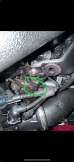

Hi folks,
So swapped over to a gsa tank including the new pipework including injectors.
Thought initially it wasn’t running correctly because downpours and exhaust were not fitted.
Got it all fitted now and when I start I need to give it throttle to run. Adjusted the isle on the cable but it’s got like a backfire as you release the throttle.
I’m thinking it’s possibly the throttle bodies being synced but should I refit the original injectors?
There is no fuel leaks all seems ok.
Any thoughts experiences from anyone?
Cheers
Mark
Thanks everyone, that’s it the routing of the fuel hose to injector was pushing against the throttle body cable and pushing it back.
The pic you will see the fuel line now routed behind the throttle cable. Before it was in front.
Removed and rerouted and it’s running sweet as a nut.
I pushed against the throttle cable as it was before and it started to pop and bang so was definitely the problem.
Thankyou guys.
