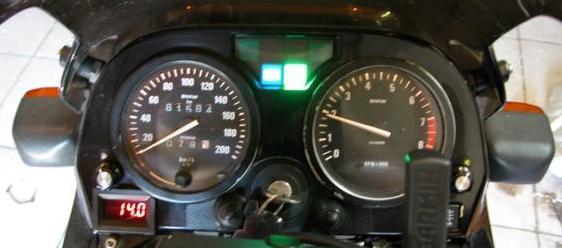

I went for one of these: digitalmeter. Mounted in the dash on the PD. I like it;)
John
