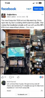

Let me know what you decide because I need to look into this tech more cause I’m still rattling around with the old nav six and feel I’m missing a trick
how old is Nav VI thingy?
The navigation cradle that came with my 2023 F 900R could take Carpruride straight away without any issue but you have to go for the *BS model (e.g. W702BS, NOT W702S etc.). I think all you need a Carpruride or Chigee and that's it. They basically do a Wireless CarPlay, hence need to charge the phone as well on the go.
Ordered this handlebar pouch to keep the phone and use the provided USB port for charging, if you wish to walk that path too.
I charge mine on the go in my 5ltr tankbag anyway and the cradle is the 4 button so not sure if they would fit. The buttons on the left-hand side might restrict the size of the unit so more research me thinks. If anybody out there knows the answer, do please tell.

I’m going to have to look into this a bit further so if you find out before me, please let me know. I know the four buttons won’t work, but I’m not bothered as I don’t use them anyway and I don’t use the under wheel as far as the navigation is concerned, only need touchscreen.
