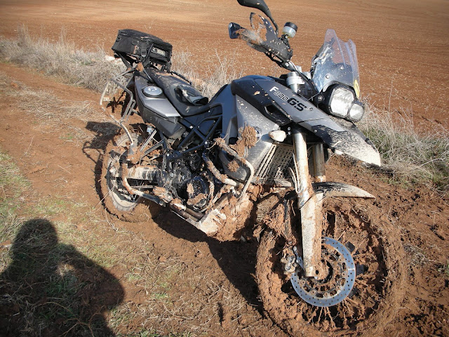

This weekend I was in a really muddy place of the center of Spain. Well, it was not mud, it was clay and we had a real hard time; we spent 4hours to make 3kms. There was 1DR650, 1KLX650, several F650GS (old), 1 R1200GS, 1 100GS, 2 Africa Twins and 2 F800Gs. Both F800Gs broke in exactly the same point.
All the other bikes were able to dismount their front mud guard and to continue (in the hard and difficult way), but we (the owners of the F800gs) were completely stuck for something that I consider a design failure as this bike is in the “enduro” section of the BMW Motorrad web site and the commercial slogan was “unstoppable”. The second one is not true.
Here you can see some pictures on how the situation was.
http://picasaweb.google.es/carlos.aisa.luis/20090118OdiseaEnElBarro?feat=directlink#
Well, what happen is that we broke the front mud guard as described in the following picture:
Mud started to accumulate under the guard and we have to ride 100meters, stop to clean it, ride 100m, stop and so on. However, at some point the mud guard broke from the red lines in the picture above and this part of the guard was out while the part signalled with the pink arrow remained in its position.
This small piece of plastic was able to turn due to the screw with the yellow arrow, so when the well did 2 turns and accumulates mud, this was forcing the plastic to move to front and breaking the wheel (the yellow screw has not the same center as the wheel).
We decide to take out the remaining plastic bit and this even worst because the mud we accumulated in the wheel and when it reached the breaking conduit that passes close to the wheel, they collide and the conduit was forced against the wheel, so the knobs of the wheel collide with it and the wheel was suddenly stopped. This every 3meters….
Why our “enduro” bike has the break conduit so close to the wheel? Why is not together with the conduits with green arrow?
