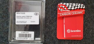

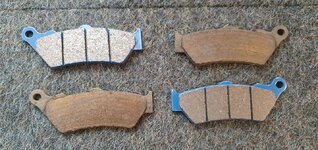

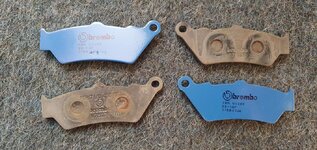

OK... Can somebody tell me whats going on here??
I recently bought some Brembo rear brake pads for my R1200GSA.
They arrived with the same profile as the old ones, however, the pad design is different (that being said, my old pads are very low and may have worn the markers off), the colour is different, and the pad material is different.
Are these new pads actually Brembo, or a knockoff?

Lack of wear-indications on the old pads is most likely due to wear.
As the pads seem to be delivered by MotorWorks, I think that if they were knockoff, MW would say so.
Since the pad material is different, I think that is the reason why the pads look different. Different colors to different materials make sense.

Genuine but not oem fitment , according to BMW parts list the LC models should be fitted with Sintered pads (part nos 34218562163)
