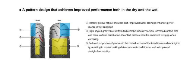

Just found this - https://www.bridgestonemotorcycleti...m/en-us/product-results/battlax-adventure-a41
