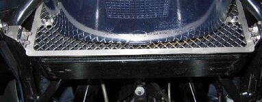

Hi capsize, i have only just finished making the stainless oil cooler cover for the 1200, a few other members are getting theirs next week and i can supply you the week after (early Oct)
Cost is £33 inc p&p for the UK.
It mounts under the beak with stainless screws and nyloc nuts which replace the original screws holding the beak on.

Not shown in this early shot but nyloc nuts are used where possible.
All fasteners are A2 stainless.
