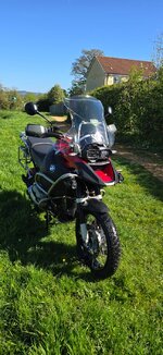

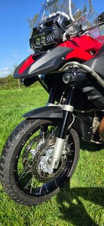

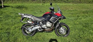

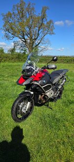

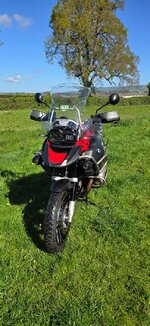

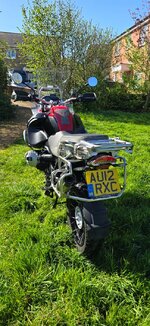

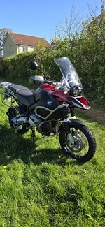

BMW R1200 GS Adventure 2012 TU £5995 One previous owner. Purchased from BMW Motorrad Ocean Plymouth in October 201720260419_101230.jpg20260419_101230.jpg
I spent three or four months looking for “My perfect for me” GSA to replace an aging R1200GS and F800GS. My requirements- Late HEX-head Twin Cam without ABS or ESA. It took a while but my old mate from this parish (Wrighty) found this for sale in his local BMW Motorrad dealer in Plymouth. A few days later I was on the train from Taunton to collect it….
Recent works include a full service at BMW Specialist: Studleys M/C (Dorchester).
New OEM alternator £720,

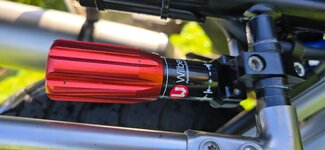

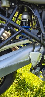

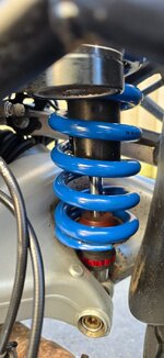

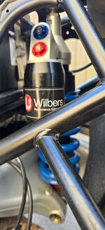

Wilbers rear shock -£1260
Drive shaft and associated parts £1058 .

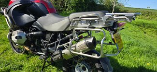

Panniers, Top box and OEM pannier bags are included in the sale. Other accessories have been removed.
The bike is in tip-top condition and I would happily ride it across Europe on one of my European tours.

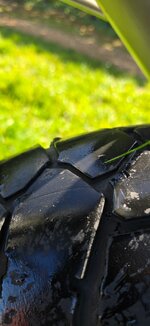

Rear tyre depth 2.5mm
Front tyre depth 3.5mm
Registered 9/3/12 AU12RXC
Current Mileage: 57945 miles
Next Service due 60295 miles
Mot Expires 15 Nov 2026
1 Former keeper

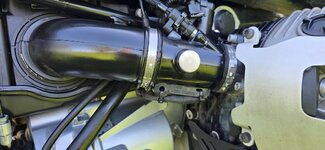

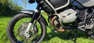

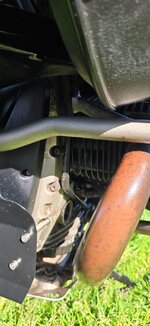

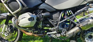

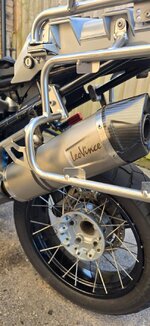

Removed 44mm OEM Downpipes and fitted Remus Stainless Steel 48mm pipes without Cat. Exhaust power valve flap refitted. Exhaust studs 21NM. Applied copper-ease grease. O2 sensor 45NM 22mm spanner. Bit more fiddley compared to my 2005 R1200GS. There is a protective cover underneath the cylinder heads- 3x bolts to remove. Also the aluminium head protection. 4 covers in all! Also removed the black Cymarc Alternator cover to remove downpipes. Applied ACF50 grease to all 4 bolts on Cymarc cover.
Went to start bike but the battery was almost flat, barely able to turn the motor over. Put on Optimate
Think the serrated footrests have punctured the sole of my left Altberg boot through Vibram badge- repaired using instant gasket. Will send off to be re-soled as they have been in service for over 5 years.
24/1/18 Adjusted exhaust joint to silencer connection. Improved quietness.

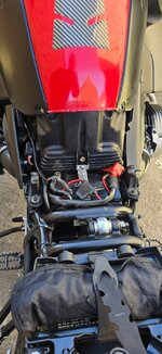

27/5/18 19186m Fitted 12v power socket for tank bag power to charge phone etc. 10amp fuse.
Sidewinder pump works ok directly of CANbus controlled DIN socket underneath seat.

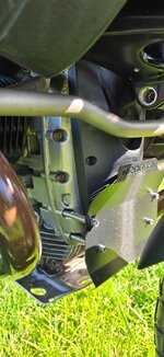

23/3/19 Fitted Cymarc oil cooler protector and toolbox stainless steel with black powder coat

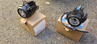

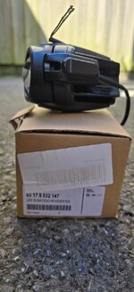

Fitted OEM BMW Led fog lights

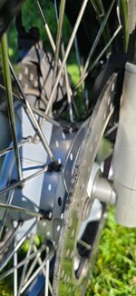

Cleaned threads on Disc bolts-Loctite 243 19NM

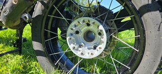

3/3/20 31270m M&P supplies Ferodo Brake discs and Titanium bolts for cast wheels

14/3/20 31270 Re-fitted cast wheels Fernodo Discs and titanium bolts

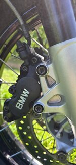

7/8/20 33489m Replaced front brake pads with Brembo 07BR26SA
Cleaned callipers,
Checked content in brake fluid H2O: Front 3% Rear 4%
Flushed brake fluid

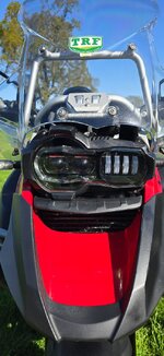

25/11/21 38,000m approx. Fitted LED headlight from China £181

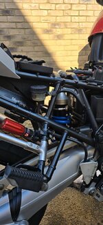

15/5/22 Started stripping rear sub-frame in prep for re-spray to address the corrosion. Rubbed down and de-greased using Hammerite thinners. Painted with 6 coats of Hammerite Satin Black.
29/5/22 Reassembled. Removed Odyssey battery and fitted Lithium battery for summer

6/10/22 45704m Mot – no advisoriesJ First MOT with new LED headlight E(

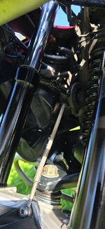

14/3/24 49850m Ordered Wilbers rear shock with remote preload adjustment.

Swapped Lithium battery with new YUSA YTX 14BS 200CCA

19/3/25 54221m Spoked wheels fitted Anakee ADV

8/6/26 Removed Denali loom, controller and lights. Fitted OEM Fog lights (not wired in currently) Have new OEM LED fog lights available.
