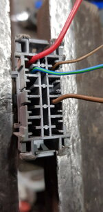

The can bus data can be picked up from the 4 wires that feed the round socket under the seat .
I have wired an OBD2 connector in parallel with the round 10 pin socket, I use this to feed an Innovate LM2 so that I can record up to 32 data channels as well as the air fuel ratio from 2 wide band lambda sensors.
Socket looks a bit ropey as it is off a scrap car.
Also handy plug the OBDLINK MX+ into.
Wiring for back of OBD2 connector.
