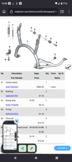

I have a question for those of you that have refurbished your centre stands as mine is about to get a facelift.
Looking on the BMW parts catalogue, it shows a stand that doesn't actually match the design of my stand (the workshop CD does show the right stand, but not the parts in and exploded view).
Looking at the image below, a screenshot of the BMW parts list, is there really just one piece of part #2? Or are there two - one each side?
As you can guess, I haven't got into it yet, looking to buy what I need and then get into it with the parts ready. Any tips are welcome

What does the supporting text say regarding the number of items ?

So do you think the stand is only attached on one side. :D
Yea. How else could it be?
But, mechanically speaking, it is not actually a given that there are bushes on both sides... Hence my question
That's what I did first. On the fiche it shows the image I shared and just gives a cost, with no mention of quantity
I'll have another look at the workshop manual, but in my first look, it focused on the bolts/bush arrangement highlighting some greasing locations, but not quantity!
**small update: I looked at the workshop manual again. It's remarkably vague. It just refers to 'bushings' rather than give a quantity.

I'm not doing too have any problems doing this job. I'm just trying to get a heads up and have any parts to replace on the ready (bushes mostly I think) and of course picking up any do's and don'ts along the way if possible!
But now I know it needs only one bush thanks to Steptoe's confirmation

Have a look at the column labelled "Qty " 😉 The diagram only shows one side because the other is identical

Ok. Now show me on here where it says two pieces
