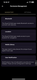

Top left in app, profile, then the cog wheel, permissions it says bluetooth needs to be on on users phone settings.

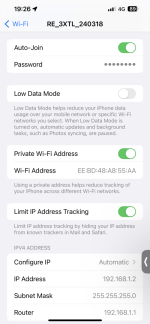

Have you looked in your wifi page on your phone, i have included a screen print of my settings. Is auto join on?
