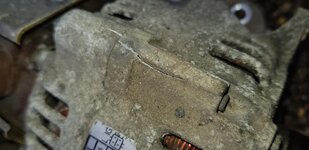

It may not be a toast battery, just a flat one, a buggered alternator is usually evident by a cracked casing on the top. Losing the indicators, clocks, whatever is the system diverting battery power to run the bike because the alternator is probably dead.
Lift the tank to get a good look at it.The vented area will usually break away with bits falling inside the alternator making things worse...
Moisture from possibly washing it before parking up seizes the alternator, screeching is the belt slipping over the alternator pulley, once it frees the alternator the damage is probably done, £550 ish for a new one or motor works / sherlocks.

Did you wash your awesome steed before putting it away for winter ? Anyway sounds like your alternator is seized. The body will be cracked and swollen - I’ve a few examples on the shelf to show customers the consequences of spending too much time cleaning their bikes.
Yep, looks like it was seized.. That'll be one expensive pre winter wash. :eek:
