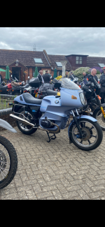

I quite like my RS77 - did the Colombres Rally on it 2-up in 2021. It’s comfortable for me (5’11”) and found rotating the handlebars in the clamps made a remarkable difference to riding height and comfort, wind noise etc. Brakes are awesome. I could be tempted to part with it but with all it’s upgrades and as I am second owner I always thought it a keeper.

That is beautiful. Is that a long range fuel tank?
