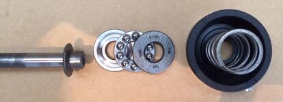

Clutch release mechanism question
Just been gathering together the bits of clutch release and, according to the diagrams I can find, there's a bit missing. The bit in question is the piston marked '3' in the diagram. I don't appear to have one. Do they all have them?
The bits I have got are in the pic. The thrust bearing races have the same markings but the internal diameters differ - 10.95/9.97mm, why?
Any insights gratefully received...

Yes your missing a piston, though there were differences throughout production, look here
http://www.largiader.com/articles/throwout/
