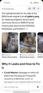

I notice on the RHS of the engine just below the RH cylinder that there is an allen-headed bolt and I'm not sure what its fucnction is - see image below
Could I remove this bolt and fish a small tube in and get down to the oil in the sump ? Anyone know what this bolt does ?

Its an Oil pressure relief valve and you won;t get to the sump through there !
