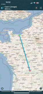

When I export a route from MRA to Garmin, it appears as a straight line.
I have attached the route the XT2 owner created and emailed me. That too is a straight line. When I recalculate it, it takes over 13 hours to get from Caen to Limoges.
Could anyone assist please with a process to avoid the straight lines and that we all end up with the same route.

download the route as a track and route. and then use basecamp to convert the track to a route, it works as i have just done it the green was the track i downloaded with the straight line route, the magenta is the converted track to route along with the straight line route

Lee, I have just noticed that your BaseCamp screenshot route, looks a very different shape to the one offered up by MyRoute.
I’ll try it in Pocket Earth, too…..
A dead straight line:
Odd as Pocket Earth is usually very good at dealing with junk.

Richard i downloaded the file from this thread, uploaded it to mra and then downloaded it to my desktop as a track and route, converted the track in basecamp to a route and its identical to the mra one infact the mra track is under the converted route. i have not uploaded the route to my zumo as yet. but will do, but with only a start and finish it will use my settings to plot the route as you will know.

I see Lee, that your version of the route has a distinct bulge at the bottom to the west, whereas my MyRoute version has a bulge to the east.
I guess that is down to nothing more than routing preferences. MyRoute has taken the fellow down the motorway at the end. Your version has probably routed the fellow away from the motorway.
My honest conclusions are:
A. It is a very long route to have no shaping or viapoints in it to nail it down.
B. The file in the opening post does work, we are perhaps just a bit unsure as to what the route is meant to look like.
C. Some user error is possibly creeping in, when the file gets bounced around different softwares and devices.
D. Straight lines often means:
1. A lack of data, the device being unable to snap the route onto any known roads.
2. Different maps; sometimes even just the base map is being used.
3. Something else.
