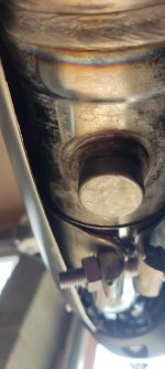

Hi All,
On a brand new 1250 GS Adventure, do folk accept even minor corrosion in the area around the joint between silencer and front section, just rear of the cat and under the heat sheild ? Bike delivered and not ridden as yet, dealer saw photos and said it would clean up with solvo polish. My take on it is that even doing so leaves deposits which will lead to earlier corrosion than expected on a new machine.
Seems the chrome finish I was expecting has been compromised or even missing in that area under the heat sheild.
My 2013 GS and 2020 R9T both owned from new still have gleaming exhausts without any external sign of corrosion, am I being unrealistic in my expectations or are they all like that sir ? Dealer collecting bike tomorrow so we shall see what their "technician" says and whether they feel it is a warranty job courtesy of the mothership. Got the feeling it ain't going anywhere other than back to my garage.
What do you guys think ?

To be honest it looks fine to me, there’s some discoloration from the welding which I guess is done after the chrome plating but it’s under a cover
I wouldn’t worry about it, see how it looks in 6 months but I don’t think it will change
Although it’s understandable to be pedantic when you spend over £20k on a motorbike, the exhaust is stainless and only surface rust. It’ll blue in time too.
Mothers polish with a toothbrush if it bugs you that much?!
Looks like a perfect excuse to get a Titanium system!!
Looks good to me also. It’s just an area that’s susceptible to that of discolouration. Probably why it’s got a cover. Out of site out of mind 👀

Looking at the photo's it only appears to be oxidation and discolouring from the heat of the welding process, as these being stainless are not painted after welding. Every GS Exhaust I've seen have looked like this.
Thanks guys, seems a pragmatic approach for the dealer to inspect it before I ride it and log it as a concern from new with baseline photos. Just did not wish to raise it at running in service for the first time which is why the dealer collected it today. I am sure they will say all is OK but at least there will be a record if any issues occur down the line, can't wait to get going on some jollies after first service.
When the flappy valve thing seizes which probably won't be to long you'll get a new exhaust anyway!
By way of an update - had a call from the dealer today to say they ordered a brand new set of headers to compare to my bike and invited me in to look at both. On inspection the new ones do not appear to have any corrosion so they agreed to fit those under warranty and deliver the bike back to me. Great service from a great dealer, which is why I usually end up buying from them, plus of course a great deal.
Anal I know, but so far a happy anal.
