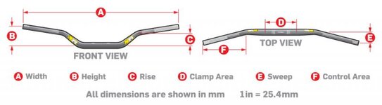

for farkles sake..... Handlebars
Fair enough though I'd have used a pipe cutter to at least score the bars for cutting or maybe had some steel bar end weights turned by a local engineering workshop.
Aye, both of them methods would work but they'd cost you more, cutting the weights were quick and easy plus the weight act as your measurement guide
Looks like the original hand guards and fixings fit ok as well?
Yeah OEM handguards, modded bar end and the sliver spacer/collar go back on. you dont use the oem bolt though. i used the M8 S/S countersunk 90mm with spreader nut. The spreader sticks out about 4mm from the bar end as it dosent fit inside (there wider at the root) but this gives you clearance for the throttle anyway. they tighten right up so theres no play in the guards to dont worry about that
All in it was 70 quid for the fatbar, 2 quid for the two M8 bolts and two spreader nuts
took about two hours all in because of painting back up the bar ends
Cheers
Tee
