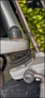

Old thread but: does anyone know which way the ‘washer’ that fits to the top of the boot go? There is a recess on one side of the washer, the other is flat.
I should have took note when I removed it from the split gaiter, unfortunately I didn’t.
The ball joint is fine.
Bike is a R1150GS, single spark (2001).
if you can give me a few days I'll let you know. In the process myself. I might even get round to it tomorrow but I did 11 hours on the bike today and I'm not sure my back will let me do anything rough tomorrow. here is mine now...IMG_6611.jpg

Is this the mystery part, your talking about?....Perhaps these images might help!
