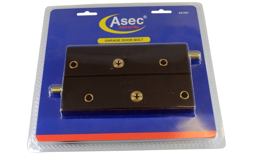

I’ve just bought a pair of those Asec security bolts for my son’s garage door. They bolt down into the concrete on either side and makes it a LOT harder to peel the door out and up at the bottom. I’ll also be bolting a piece of wood across the top where the door stops so it can’t be pulled out at the top either. Not foolproof but it all helps.
