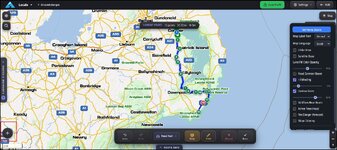

I've been playing about with the DMD2 software on an old phone and it seems pretty good and I have a free account so can use the route planner online. The route creation tool is similar to MRA and can be synced with the app. It's based on Open Street Maps.
Planning page looks like this.
Little off road sections are highlighted and colour coded according to difficulty. So much more off road focused than MRA.

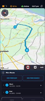

If you want to experiment with the site and app they have made it relatively easy so that you can see if it's for you, or not. Create an account on the hub download the app to a phone or tablet and sign it in. You can do a lot of things in this environment including downloading 3 offline maps and creating routes and tracks on the device or the desktop planner. You need a subscription or a DMD2 device to automatically sync routes created on the desktop with the device. For the desktop planner you start at the plus sign with the square round it.
and it brings up this dialog.
Routes and tracks are created in the same way by clicking on the map and clicking further down in the direction of travel. If you make a mistake of the route track takes a different road than that intended then you have to hit the undo button and place a shaping point on the missed road. This is the main difference I could find in route creation in MRA where you can grab the route and insert a waypoint or basecamp where you can rubber band it. There are loads of options regarding the type of routing algorithm you might want to use. Beyond that it's pretty intuitive.
Planning on the app is pretty intuitive as well and reasonably consistent with the desktop planner. The only odd thing I have found is that it routes from your current GPS position so if you want to create a route elsewhere then you have to delete the first waypoint created. That said the app is new to me and I probably haven't worked out how to start at a remote location to the device.

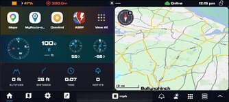

Even if you didn't want to use DMD2 route planning it makes for a good home screen for a dedicated navigation tablet. I have it on a phone set up like this. With a row of other navigation apps set up on the left hand side of the screen.
