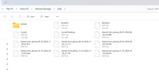

Hi I don't have a tread but I think that it would function like the rest of Garmin's motorcycle GPS's and if you connect it to a computer via USB you will be able to drop gpx files directly into the GPX folder on the unit.
This is what it looks like for internal storage on the XT. Also the computer will recognise the SD card and you can put GPX files in a Garmin>GPX file on the SD card.
