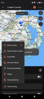

The explore app is not designed for motorcycle use however, if you have it on your phone it gives you access to your Explore library and collections if you have not enabled the link to these in your XT (and I would strongly advise that you don't if you don't want tracks and routes all over your XT map if you have inadvertently turned on your Explore Library and are out of 4g or wifi connection to resync with the server) This means that you have access to routes and tracks in your library that you can send to your XT via the drive app. This could be useful as a backup to other routing applications that you may have. The routing aspect of the explore app has been much improved and is very easy to use. The "gotcha's"of the old app were two fold (unless I'm mistaken) it only produced tracks (called courses in the app no doubt a nod to its intended use for cycling and hiking) and it did not route via roads not suitable for cycle use i.e. motorways and highways. Its a shame that no routes on highways is still the case as the apps routing interface is now very easy to use. However the app can now produces routes (formed by all the points you input to create the track) so I though I'd try it.

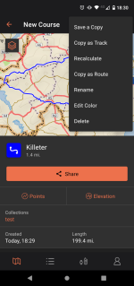

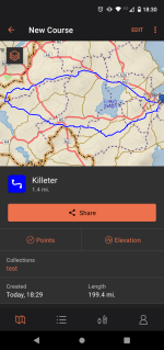

I created a course (track) to ride last Thursday. Quite long about 220 miles door to door. The app now gives you the option of saving the course (track) as a track and a route. This is handy as if you put a shaping point before the motorway section and just after the Zumo XT will route along the fastest route i.e. the motorway. You can see above the raw track avoids the motorway.
Sent both the route and the course/track to the XT in the normal way.
You can then make sure the route follows the track/course you've created by making the track visible on the XT map using the tools on the XT. This illustrates the XT's fastest time logic as it will take you down an A road and back up a B road adding miles to your Journey (and time) if you don't place a shaping point on the twisty B128 as intended here. That said, its easy on the XT to plonk an additional shaping point on the preferred route.

2. The app has lost the ability to save a "Course"(Track) as a route which contained the shaping points used to create the course so if the course/track is converted in the unit the only points are start and finish. Routes and tracks contained within your collections can still be sent to your XT via "Drive" so it might have some utility as a backup for your routes if you don't use a third party repository like MRA.
