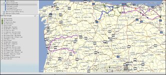

If I travel, I generally plan in advance routes and options day per day. Both routes and tracks (tracks for both backup and eventual offroad options).
I do use alternative mapping in some cases, generally off-tarmac.
Usually longer trips look similar to this:
