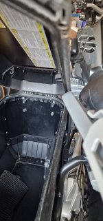

Hi Problem is that the LH Alaska pannier lid fouls the bikes grab rail and cannot be opened on the bike. Not too much of a problem if you could use the hinge out mechanism built into the Alaska pannier (Givi call this the "hold it fast" system. Essentially, the “hold it” arm is designed to clip on to a straight length of tubing, whereas the PLR 5108 has a length of tubing in this area with a curve, which means that the arm is only partially engaged with the rack and will fall off with any weight in it when hinged out from the bike, on your feet if unlucky. Givi have told me that the design of the rack was changed in production, with no account being taken of the "hold it fast" system. Here's some shots of the problem with the hinge and the lid. Givi have told me, in writing, that the Alaska cases are on compatible with the PLR5108 rack. They're still selling them though. I bought the PLR5108 from Sportsbikeshop, who have been brilliant as always. Givi couldn't seem to care less.

If I remember correctly I’m pretty sure I relocated the hold it arm. I believe there are another set of holes to allow this. I know I had to adjust something.
Been a while and I’m going from memory but I’ll have a look when I get home tonight and let you know.
