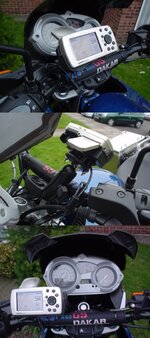

Has anyone fitted a GPS system to a F650? I'm waiting for Vines of Guildford to revert re the fitment of the new Nav II Plus.
Thx for responding Nick. Can I ask what I should pay? where did you source it and the bracket? is it battery powered or wired in? is it water proof (riding around Ireland)? are you happy with it?
Typical price for the Quest is around £350. I got mine in Maplins.
The mount is the original Garmin unit, so is powered. I have hardwired mine to the battery, but I think I will change this to use the accessory socket as I worry about leaving 'live' pin connections when it is parked.
The mount costs around £40 - £50. I got mine from Rainbow Motorcycles.
The original equipment Garmin cradle fits directly onto the RAM-B-202 circular mount - all 4 holes line up perfectly.
I used a RAM-B-201 3inch arm, and a RAM-B-231 ball joint mounted on the handlebars. Another £50 or so.
Seems waterproof. It has been out in the rain, and splashed through enough Fords and Rivers.

Nick's pictures are fine and show you how to mount the Quest. If you intend to fit elsewhere then its chat time.

Many thx for all the advice! I bgt my Quest GPS and Ram mount from the GPS Warehouse in Hanworth, Middx. Cost was £355 and it works like a dream! Decided to stick with the battery rather than hard wiring it.
