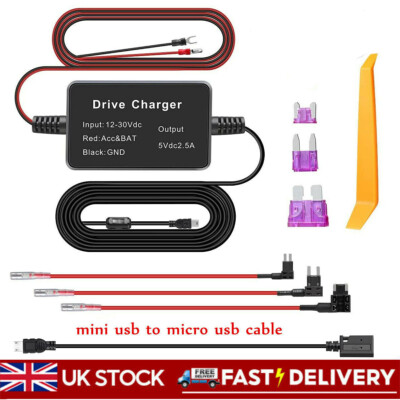

And another to the 5v power supply I bought.

Bought an adapter off eBay for a couple of quid .
I’ve tried looking on my order history but can’t see it ,will keep looking and post link if I find it.
Yes it works fine ,as you say I think it’s just a plug that only has the pins that connect the power to the unit .saves having to determine which pins to cut yourself and for the cost why bother with the DIY .
