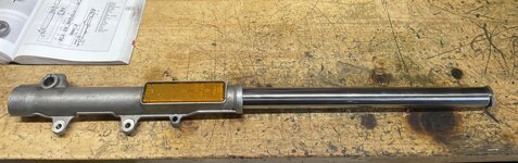

I discovered an issue with the left fork leg when I fitted the gaiters.
The slider just dropped off the bottom of the stanchion. Nothing appeared to be holding it all together.
Got the left leg on the bench this morning to see what’s going on.
First job is to remove the big M12 cap head that holds the damper rod in.
Not knowing if this has any thread lock on it, I warmed it with a hot air blower and buzzed it off with a windy gun.
Got the leg contents spread out on the bench
Time for a clean and compare everything to a parts diagram to see if anything is damaged or missing.
Fortunately it’s all there and I think I also
found the smoking gun. The piston had become undone from the top of the damper rod.
A quick trip to Wickes to buy some threaded bar resulted in a cheap tool to pull everything together against spring pressure, so I could re-insert the retaining circlip..
And it’s all back together and stays in one piece 🙂
Time to order some copper sealing washers and I may as well replace the fork seals now I have a method.
