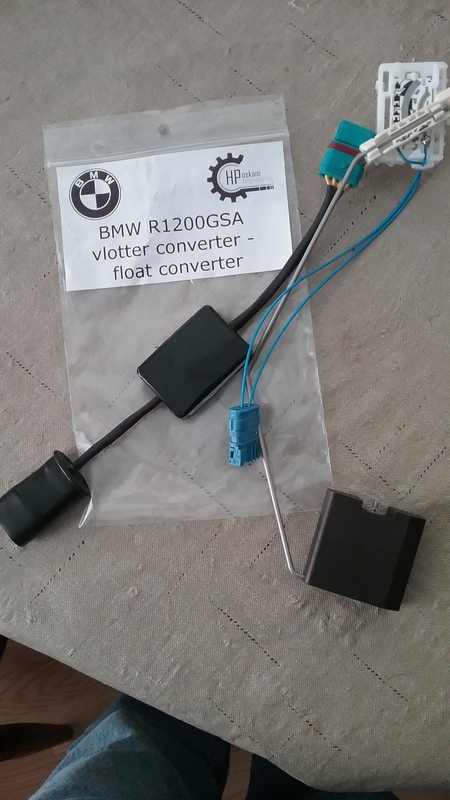

This dutch guy used to sell a little converter that could be used to replace the fuel strip with a float. The little converter would "translate" the float signal to those of a strip before it reaches the ECU.
They are no longer sold.
It works if the tank is full. It shows full tank. Works(ish) until a bit over half a tank of fuel, but then it goes back to signal empty.
It is still a small improvement over having the bike saying empty all the time, as that would keep all the pumps spinning at maximum speed.

The converter I mentioned above:

From what I remember there is another dongle that would prevent the bike to go into fuel reserve mode, tricking the ECU of always having a full tank.
