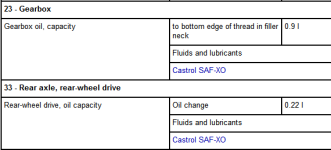

I have had an issue last year with gearbox oil dripping on the exhaust system.
It ran down from the breather plug. Looked a bit similar to your photos...
After some research I found that, at some point, BMW corrected the filling quantity from originally 0.9L (repair manual 2009) to 0.7L afterwards. Also the filling level for the FD Bevel Gearbox was reduced from 0.22L to 0.18L.
Also, I noticed that the gearbox breather plug has a new part number. I replaced it as well.
How much gearbox oil did you fill in? Could it have been overfilled?
From the 2009 repair manual... It's now 0.7L & 0.18L respectively.

Hi! Yes my gearbox is filled to the edge of the filler hole per the manual as you showed. You are right. I have cleaned the area before rides and I see the oil flowing down along the seal. I will post pics again.
