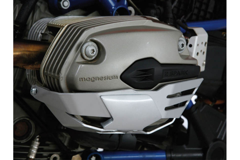

I'm a newbie to BMW and Adventure bikes so forgive me if I'm covering old ground here. I do tend to go back to basic principals rather than believe the hype about any claimed benefits of a product. From a general engineering and geometry perspective, crash bars come out a poor second to head protector plates.
Bars concentrate ALL the energy from an impact at the mounting points (except that which is absorbed when they bend :-( ). That's a lot of force on small areas of castings which were never designed to withstands such sudden impacts and almost certainly from those directions. There is a strong possibility of cracked casings (I'm sure this must have been reported elsewhere)

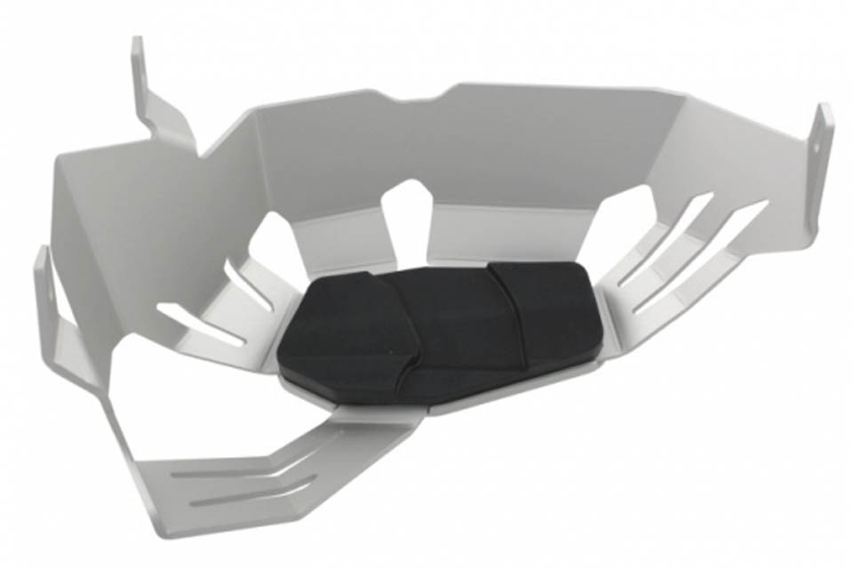

The BMW OEM, MachineartMoto and other head guards on the other hand effectively spread the energy over a wider area. They do rely on fixings in the head but also have a compressible rubbery buffer behind which absorbs the impact before transferring it to the rocker cover. The delay is admittedly very short and all the energy is ultimately transferred, but over a larger area and a longer period. Need proof ? - Hit your hand with an icepick, then wrap the point in a towel and do it again. Same energy, differently delivered, different injury - open wound and broken bits vs. a bit of a bruise. Macghineartmoto have taken this to an extreme and have a virtually full contact pad under the outer guard. The OEM 'rubber' (sorry I don't know the polymer), is concentrated around the outer edge of the rocker cover so forces are essentially down the axis of the cover screws (as well as admittedly perpendicular to the fixing screws) and through the (horizontal) sides of the cover avoiding stress to the top (vertical) part of the cover which is much thinner and more susceptible to cracking.
Finally in a crash at any speed above say 5mph, the bars are more likely to catch on a rock for instance, or dig in and expert not only vertical forces but horizontal as well, all on the couple of mounting points. The head guards are more likely to scuff over obstacles and slide further gradually dissipating energy. You will have to walk further to pick up your bike but it should be less damaged when you do.
Head guards have my considered vote.

I dropped my Adventure on slimy mud at about 20 mph. The RHS engine OEM crash bar rammed into the rocker cover and could not be removed until I unbolted the cover. The Wellard Tourateck head protector was also trashed so did its job.
But had that crash bar hit any harder its likely the cylinder head would have been damaged. Additionally the head protector mounting screws (M6) came out Z shape. The M6 screws take a shear load delivered by 2mm stainless lugs that wont bend or "give". My cylinder head lugs survived but they really are not built to handle such force.
I now have Machine Art X-Heads (bought used) but even they use the same M6 lugs onto the cylinder head and the polycarbonate is very solid stuff. As it transpired mine were brittle and the lugs snapped off (vibration). I now have 2mm aluminium plates in place of the original cracked lugs. These will bend and/or the covers will crack so, while they were sub standard, I believe they are now adding protection without increasing the risk of deep damage.
I believe a good option would be shaped to fit nylon blocks butted against the rocker cover face. They could be screwed from the inside or use the cylinder head lugs but not in ways they could get overloaded in a crash. Nylon would also be easy to buff up so a simple car park tumble need not look scruffy.
Crash bobbins would look silly and potentially dig in or be ripped away, so the protector would need to be machined or moulded to fit. This shows the vulnerable area that needs protection.
