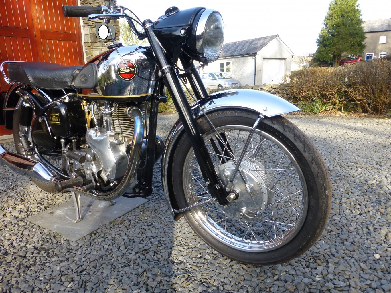

By chance I have owned both a Velocette Venom and an A10 Gold Flash..both seen below
I found the Venom to be difficult bike to live with, despite having an Alton Electric starter fitted - it was a sod to start, but pleasant to ride albeit small
The A10 was an altogether different bike, much easier to live with and a joy to ride, as long as you weren't in a rush ;)
I'm not able to offer much if anything by way of further identification of your bikes
