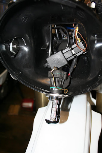

I wired up a hid bulb today.
From the instractions it looks like main/dip is facilitiated by the bulb moving.
It does move - it rocks backwards about 2mm. Is that right? It doesn't seam to make much difference - but then i haven't got it out on the road.

Pete, It's not the actual bulb that moves in the H4 light. It is a sleeve over the bulb that moves back and forth, changing the angle of light on the headlight reflector.
If you have mounted the buld in the headlight in the same way as you would a conventional H4 bulb, there should be nothing outside the headlight that moves. If there is, then something is not right and you need to check the bulb is located correctly.

Val: how far does the sleeve move, If mine is moving its a millimetre or so ? Is the movement that small?
You have it near enough correct.
There is a solenoid at the rear of the burner whcih moves it back and forward between dip & main beam.

Thanks for checking - that means there is something wrong with mine - it barely moves - only a mm or so
Yep, sounds like it's not right. Jills moves about 5mm or there abouts.
you can remove the bulb from the solernoid by twisting it a few degrees. It seperates at the green ring. You might be able to get it to move propperly then.
