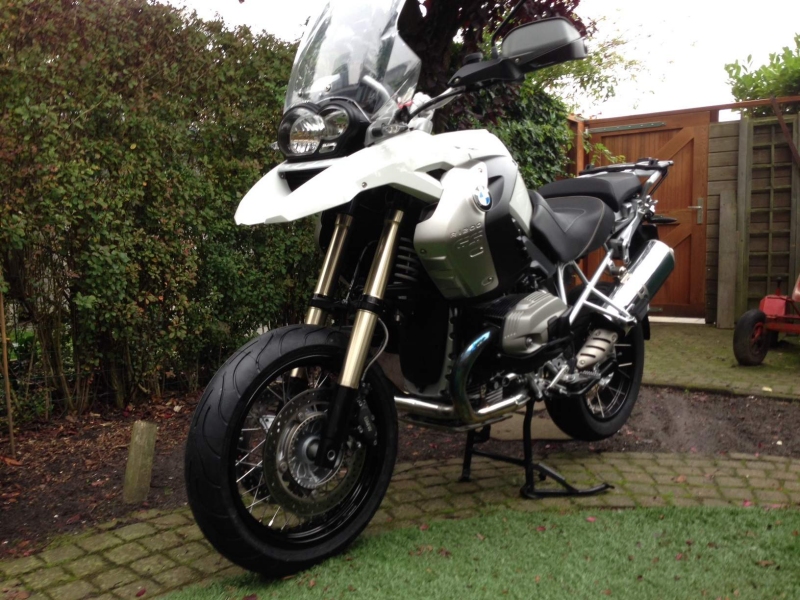

Having seen pics of a 1200GS with 1200RT wheels fitted, and wanting to improve the road handing of my GS. I’ve gone one step further and fitted some 17" 1200S wheels, which IMHO, are better looking. Plus the rear wheel is a 6.5 inch wide bugger, so it’ll take a superbike size 190 section tyre.
After doing over 100 miles on these, I ‘m over the moon with the way my GS handles now. The steering is so much lighter and precise, allowing me to effortlessly flick the bike through the curves like a sports bike. Excellent. :clap
Motorway handling is excellent also, just as stable at high speed as with the standard wheels.
Ground clearance doesn’t seem to be a problem so far, though I haven’t really done any proper scratching on her yet.

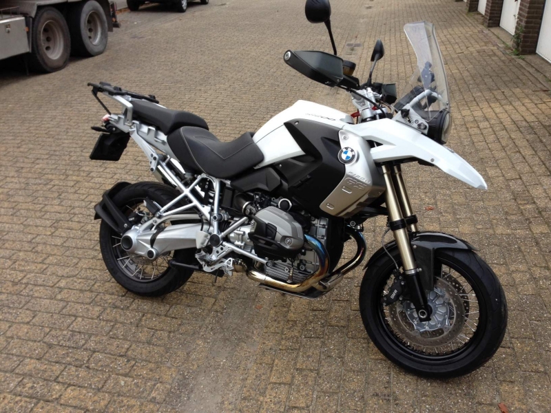

I've done my '05 and my new '07 as well. Here is a pic of the '07:
The rear offset is a bit much. You don't notice it unless you take both hands off of the bars and then it pulls to the right pretty hard. I fixed it on both bikes by removing .150" from the mounting flange of the wheel and also .150" from the rear drive flange. Very simple to do resulting in no pull at all :) Another thing to watch out for is how close the front disc support comes to the caliper. It actually hit the r/s caliper on my '05 and was extremely close on the '07. Its a 10 minute fix to get .040" clearance with a grinder and a can of flat black paint. You have to take just a bit of material off from an area about the size of the tip of your finger. No big deal. The bike is only lowered at the pegs by 1/2". The rear wheel is the same size in diameter as the stocker while the front is 1" smaller. The bike drops into turns much quicker with less effort. It tracks beautifully as well. I powder coated the '07 wheels gloss black for a paltry $75 for BOTH wheels! Powder coating is so simple compared to wet painting anyone could do it. The powder is electrically charged and blown on the wheel which is then placed in an oven for 4 hours at 400F. Presto, perfect finish. I had an industrial guy do it. Dropped them off in the morning and picked them up in the afternoon. He probably had a total of 30 minutes of labor invested, hence the low fee. The front fender is a cheap laid up piece from Boxer-Design painted flat black to match the other plastic bits.

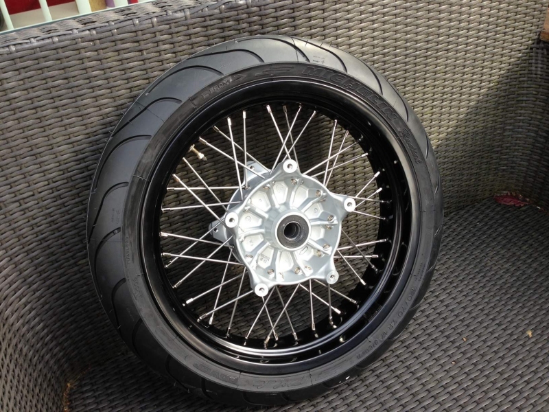

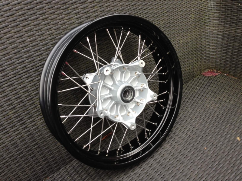

I took a 17 inch wheel of the 17" SM set a HP2 Enduro

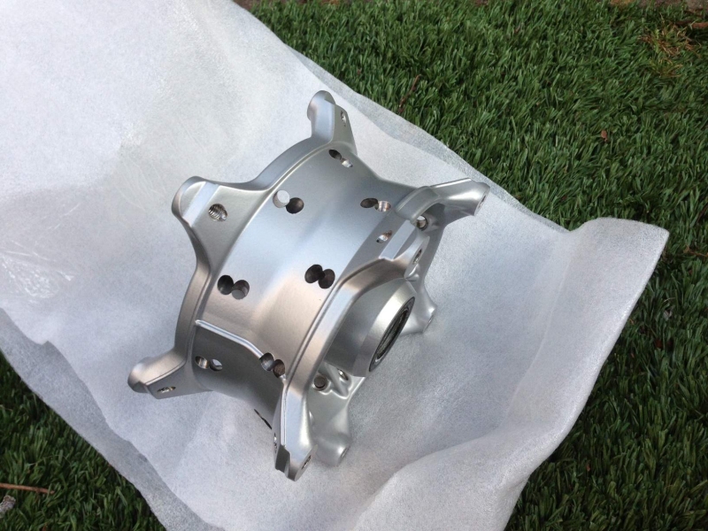

Dismantled my own 19"
Haan Wheels spoked the hub into the 17" rim for me

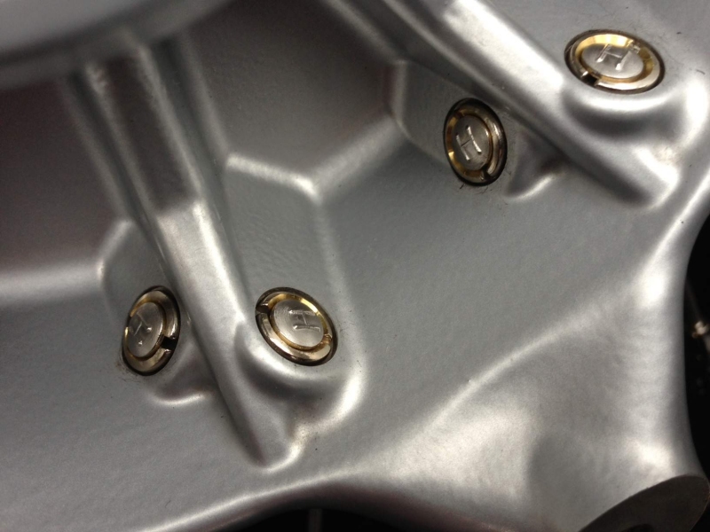

Little H details
17"carbon hugger
And Voila! :beerjug:
The brass ferrules look great & are what's missing from BMW wire wheels. Copper dramatically reduces the electrolytic effect between aluminium and stainless steel.
