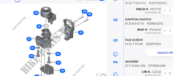

Sounds more like the ignition switch. Part 2 below.
I'd agree with the above post.
If nothing at all comes on it'll be that.
It'll only get worse. I think mine was about £80.00 about 10 years ago. I'm sure it's probably a bit more than that now. Easy to replace.
Price is about the same from the page above. Plenty of threads on how to replace.

No joy with the contact cleaner but worth a try, thanks! Replacement ignition switch is the part number shown above, which was 82 squid including the vodka.
