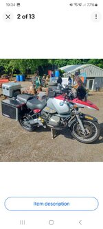

OK so I know there has been info all over the net and site but a lot is from years back. I got a 95 r1100gs with 114k on the clock and I think the original injectors by the looks of it, just finished putting the john gemi chip in which made a huge difference and now thinking is it worth upgrading the injectors so that i get the most out of the new setup. I see motorworks do a kit they do used and new injectors, is it worth getting used ones or by used do they mean reconditioned? Or any other cost effective options out there. Happy riding guys and gals 👍
Here's my old ride, enjoying it more then a lot of newer bikes I've had....a side for nearly dropping it a few times 🤣
