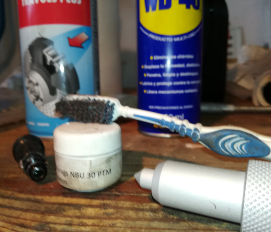

Jürgen Tills in Westphalia is a good trader. He supplies lots of nice thoughtful things you might need for our bikes. I was pleased with the way he included a tiny little pot of the expensive Staburags NBU30-PTM high-impact clutch repair grease that they use at the Berlin factory - or used to decades ago when they made single-plate dry clutch assemblies - included with the slave cylinders I got from him at tills.de. Klüber Lubricants are reluctant to sell an individual rider one of their vastly-expensive 150 gramme tubes of the stuff, so till's idea of a titchy little pot of it for only a couple of snoojits is a great one. Coz you only need a pea-sized blob to lube the splined shaft and friction-plate hub.
