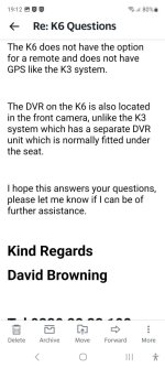

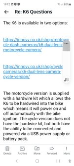

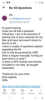

I'm just about to pull the trigger as well on one. Have you looked a the new K6. Although it says it needs usb portable power as far as I'm aware it can be hardwired. The beauty of this system is the front camera is much smaller even though it has all the techy stuff inside and the front camera is a 2k. The k6 is also cheaper.
Not trying to hijack your thread just wanted to give you the heads up of an alternative.
I'm gonna ring them early next week with a list of questions ,one of which is the power issue. If your willing to wait I'll post the answers here to you

Hey abermac got reply see above
Cheers
Ollie
K6 -2k camera front ,rear 1080p
Field of vision 140°as opposed to 120° on the other models
