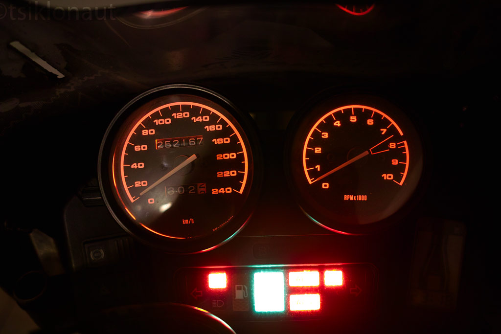

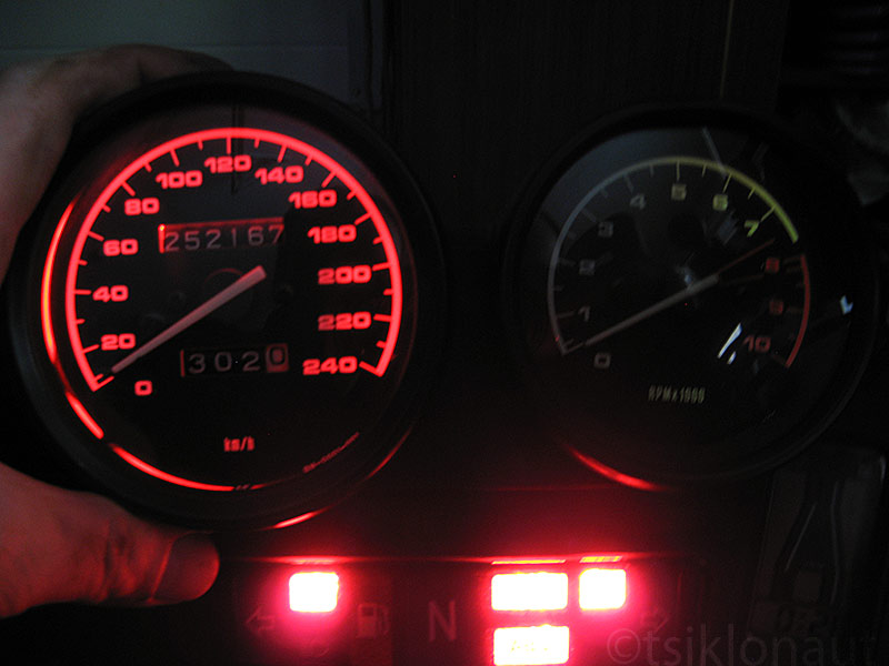

This is how I sorted out my dash - with red leds:
Versus regular bulbs. See the illumination difference.
The end result.
With the red LED mod the bike's now easily 5mph faster on top speed :thumb
Cheers guys, Siklonaut - which / how many LED's did you use, ive bought from 'ultraleds' before are they there ? Just curious about the red colour - I noticed that in the Golf the blue lit dials are really clear but the red lit odometer is blurry !! trying to find out before I take it apart !
Cheers
All 4 LEDs replaced, 2 per each dash.
Those are just my crappy handheld photos in a dim light - those red LEDs make the dash clear and contrasty like any other. Didn't like natural white, had regular green bulbs before which I liked but thought I should change and I really like the red LEDs the most - it gives modern "minimal" looks (colors dissapear, i.e. rev-limiter is just a marking, not annoying separate color) and the least vision-disturbing during the night riding. :thumb2
