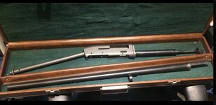

We've built a few film props for different folks usually these are to make mulitple pieces as replacements for actors who tend to loose stuff all the time...
or this for a very cheap production, they need a non firing prop gun. I did their paperwork and handed this over to the props master...
it started as a broken blank firer, we checked this changed the firing pin channel which was drilled out that stopped it being a blank firer and then we got the props department to make a solid barrel / allowing actors to rack action... (obviously there's the VCRA to consider, we advised them of this and the paperwork reflected the best practice. it had no barrel and so could not load or discharge blanks or other live ammo)
get the thing to bits, prep and spray in armour black...
job done.... the benefit it's the simplest air cure and there was time to get it sorted

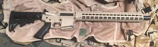

I work with ASE utra these are the strongest all steel units on the market.... this was a low IR signature paint for use in anti sniper situations.... (but that's another story)
there's also sand coloured toys...

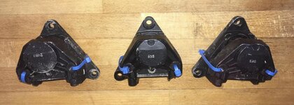

brake calipers being restored, these have some specific tolerances on the inside so need to be treated with some care...
the client wanted them to remain looking aged so the details of the casting was nice to show as the paint is so thin...

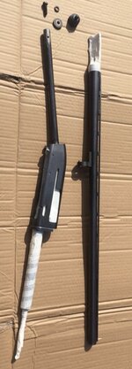

this was a very old remington 1100 the chap wanted it tricked up for shooting on the salt marsh.... the action became tungsten the barrel barrel, magazine cap black...
the alternative to this paint would have been have it refinished at a cost of over £300 or have it sprayed at around £200.... the shotgun was worth about £250 in the poor shape it was. Worse it wasn't anything note worthy so the cheaper option was totally correct in this instance...!
and it made it look like a new item... (bit two tone drug dealer, but the chap was really happy)
