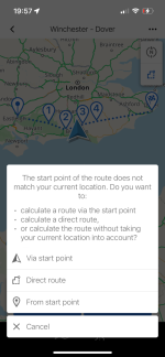

Imagine a 150 mile bespoke route, created in MyRoute, with say 50 shaping points, one every three miles.
Imagine now standing roughly half way along the route. You import the route into the Connected app.
How do you then run the route? The only two options seem to be:
1. From where you are standing, back to the start point and from there forwards along the route
2. From where you are standing to the end point directly ie. Ignoring the 75 miles of the bespoke route you’d created
Thanks for any help.

1. I have found, maybe by luck, that if you tap ‘Go direct’ it will (at least this time it has) pick up the bespoke route. I’ll experiment some more.

Picking the ‘Direct route’ option seems to navigate to the closest point (might be way or support point) on the route and then uses subsequent points to the destination.
FYI there are no limits to support points in the connected app. They’re not visualised in the app but are used like shaping points in the calculations.

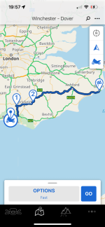

If I import the route from kurviger shown, and join from Brighton using the direct route option waypoints 3&4 from the original route are used in the calculations.

The stranger thing is that it failed to make a recalculation on a route the Connected app created itself, between my house and a road in France. I’ll make a separate thread for that one at some point.
It becomes odder. Today the Connected app worked perfectly, including a rejoining of a bespoke route mid-point and an off route recalculation. The downside? My 1600 was very reluctant to start its WiFi connection, which has been working very well.
