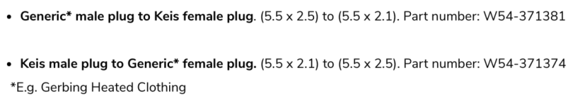

Gerbing 5.5 x 2.5
Keis 5.5 x 2.1
Or is it the other way round?

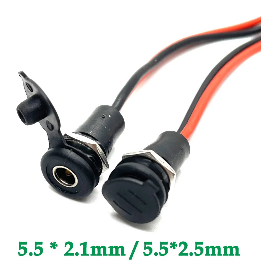

If Keis is ineed 2.1 which it is, then this cable is correct.
Also its 2 foot long which it doesn't look in the picture.

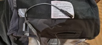

The input to the vest is as per the attached.

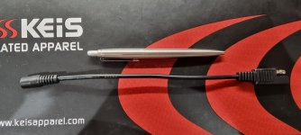

Ok just to confirm.
this week i took delivery of my Keis gear and then this
It fits great but i have yet to connect it to the bike, it is shorter than i expected...
Pen for size comparison
Then fits onto the lead at the bottom/inside of Jacket like this
I intend to have it popping up between my legs at the front of my seat so its length should be ok
