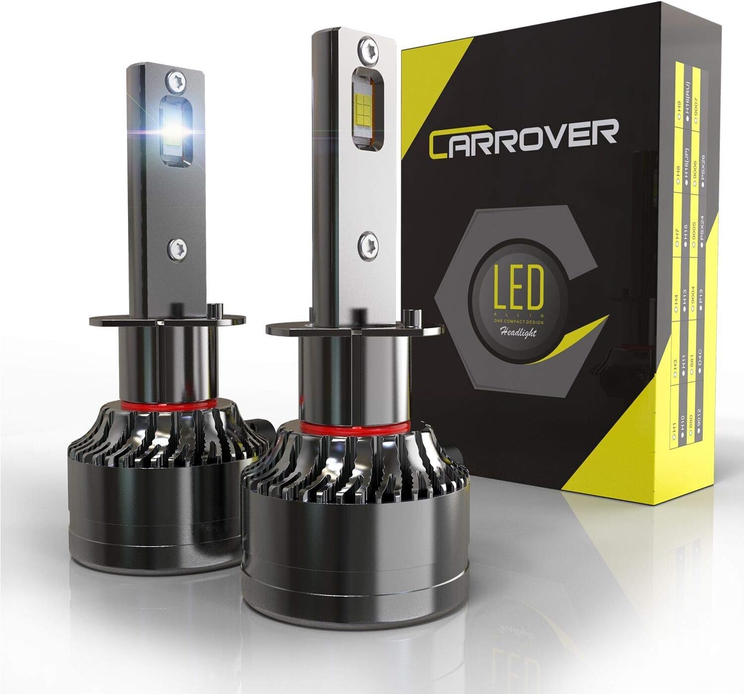

So bit the bullet and changed from HID to LED. The ones Gabriel_GS used were currently unavailable (4000LM per bulb, 6500K), so I went for the newer, brighter version (9000LM, 6000K) which have a fan and cost £40. I needed to modify the metal bulb holder slightly so allow the notches to align, but no big deal with the Dremel. Also picked up some LED dust caps which slot straight over the top, leaving loads of space around it so the original ones are now superfluous. I also drilled a small hole on the underside to help with cooling. Replaced the stock connecters with waterproof bullet connectors and tidied everything up with cable ties. Looks good to me, but its too light right now to test them properly and the MOT is tomorrow... fingers crossed, and hopefully, they last!

I’ve just got some similar ones, what do I do with the plastic ‘screw cap’ that fits on the back of the light obviously the bigger bulbs mean the cap doesn’t fit back on -
Are they ok being exposed as such??
Mine have been exposed for eighteen months or so and have suffered no ill will so I think they'll be grand.
