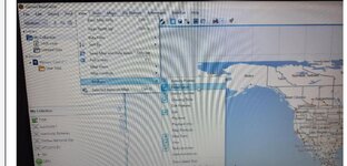

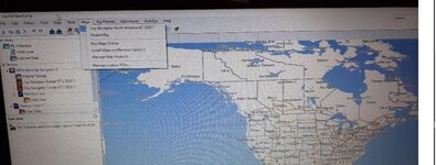

OK.
From your screen shot, you do not have the detailed European maps installed on your PC, but you have them on your gPS device. Install them onto your PC and all should be well.

According to this screen shop, assuming it shows the maps installed on your PC, you have: North America (detailed) and the Global map (base, basic, no detail)
attachment.php
That conclusion matches this screenshot, assuming you have't reduced the detail to zero.
attachment.php

I don't have a PC, so I can't help you much, I'm afraid but I'm guessing the European map (if it's installed) is not unlocked, which might match this screen shot:
attachment.php
What I can't understand is why your PC is not using the map from your connected device, which does have the detailed European map.
