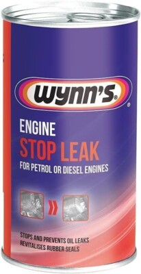

So might it be worth the OP draining and refilling with a more viscous oil in the hope that it might stop the leak?
Thanks lads… thought as much, not much I can do about it by the roadside, so will carry on… got a week here to rest it, then week home.
Good thought, it might give me a little more time…

I would avoid the Wyn's unless you pull out the paper filter!!
