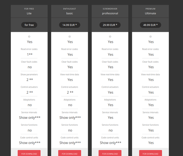

Thanks guys. I used the motoscan to reset my wife's f650gs (800cc) service interval. Then I tried to reset my mate's R1200GS LC however it could not connect. I have the professional version of motoscan. Can you only use for one bike ? Do I need to upgrade to the ultimate version to do multiple bikes?
