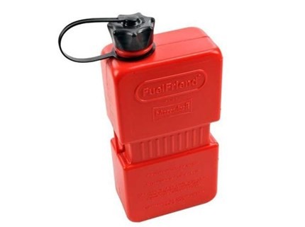

I'm sure I've seen canisters that can fit in the GS frame try E Bay
These great little cans made in Germany is exactly what you need for a small, yet solid and safe fuel reserve. Specificly made for storage and transport of hazardous substances, perfect for motorcycle trips, all small engines and many other purposes.
Features
The smallest can suitable for fuel nozzles on the market.
Emergency reserve for motorcycles, scooters, quads and other small engines.
Small, extremely robust, meets the highest safety requirements.
With eyelets fitted to the sides for securing with a tension strap or similar.
Suitable for all fuels and petrol products.
Fits:
All models
(fit with Wunderlich strap reference WUN-25120-010)
Found this on nippy Normans ill keep looking.
