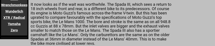

You maybe on to something Mikeyboy...
eBay no - 113140910690
