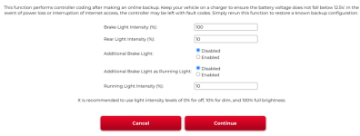

The GS911 diagnostic unit can now turn off the running lights on the 1250 and 1300 2024 onwards, both front and rear.
What's your query?
Since I started this thread, I'll just update that I had my bike reprogrammed using the recent GS-911 release, so it is now set up exactly how I want (i.e. like a 1200 or a 1250 without the "smart" indicators).
Any chance you can post a photo of the settings page on the GS-911?
I have the Aux lights too, so want to make sure that they continue to work, while the indicators are no longer on as running lights, and only work as standard indicators.
Cheers.
