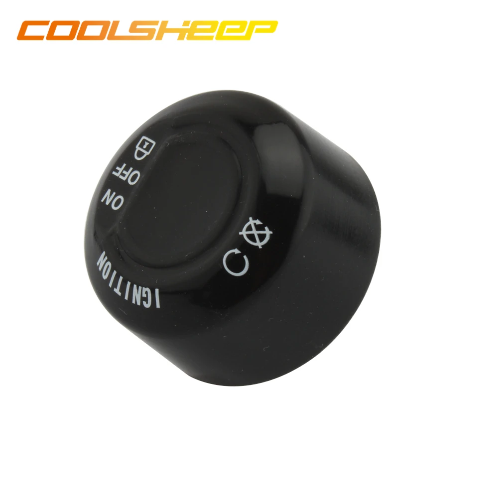

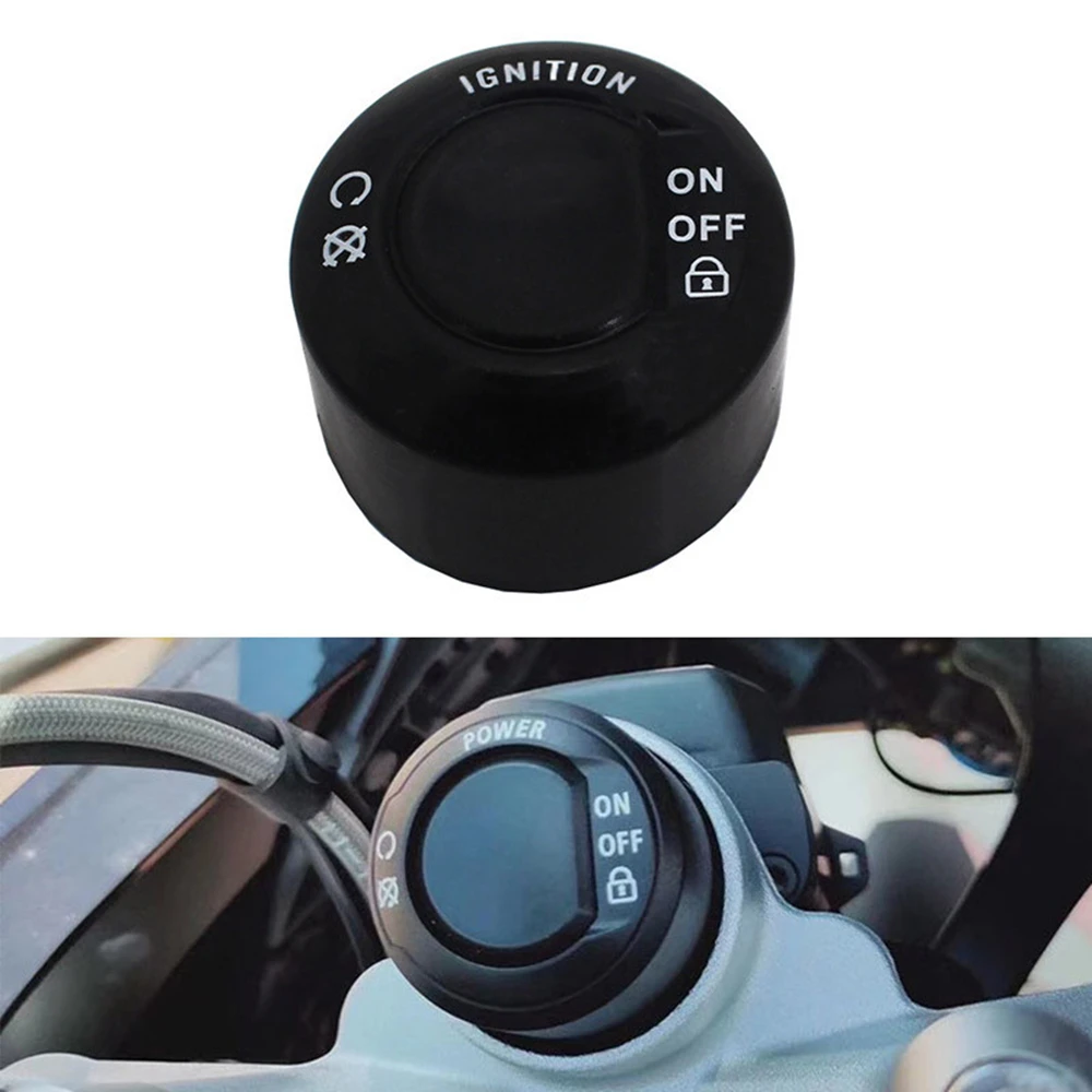

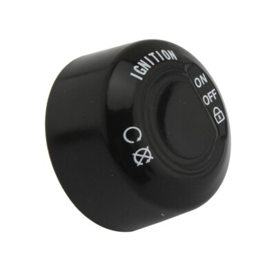

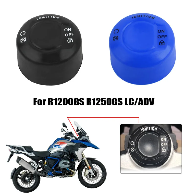

I've seen cheap rubber keyless switch covers on Aliexpress etc that I thought were pointless tat, now perhaps I think I might buy one for my bike to avoid the water ingress suggested.
Verdigris - a posh way of saying the Green Shit from Copper going bad. :D
Don't suppose you have a link by any chance as my search isn't showing anything??
Found some but on Amazon (£28!!)
eBay £4

You can get these covers for £4 of ebay
eBay £4
